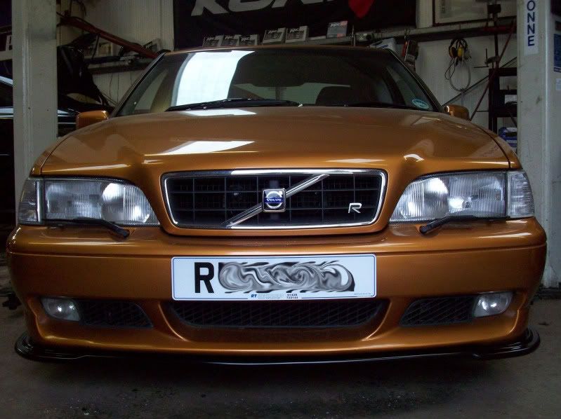

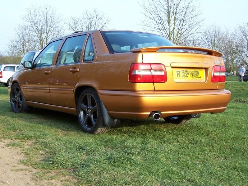

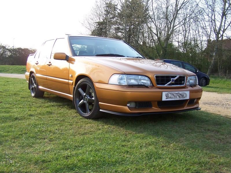

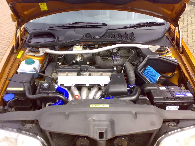

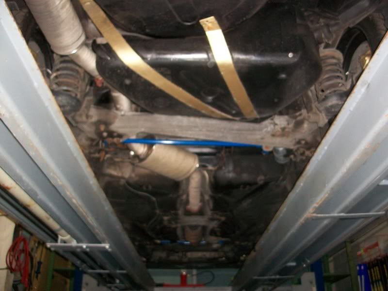

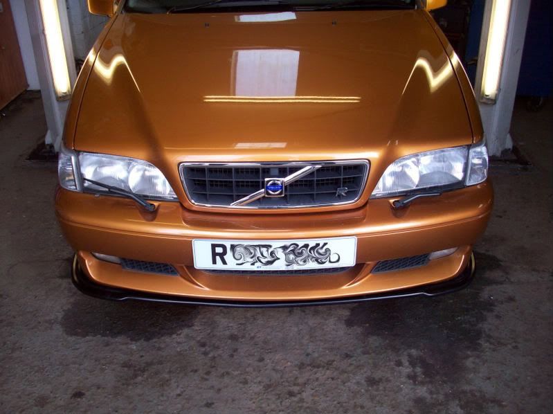

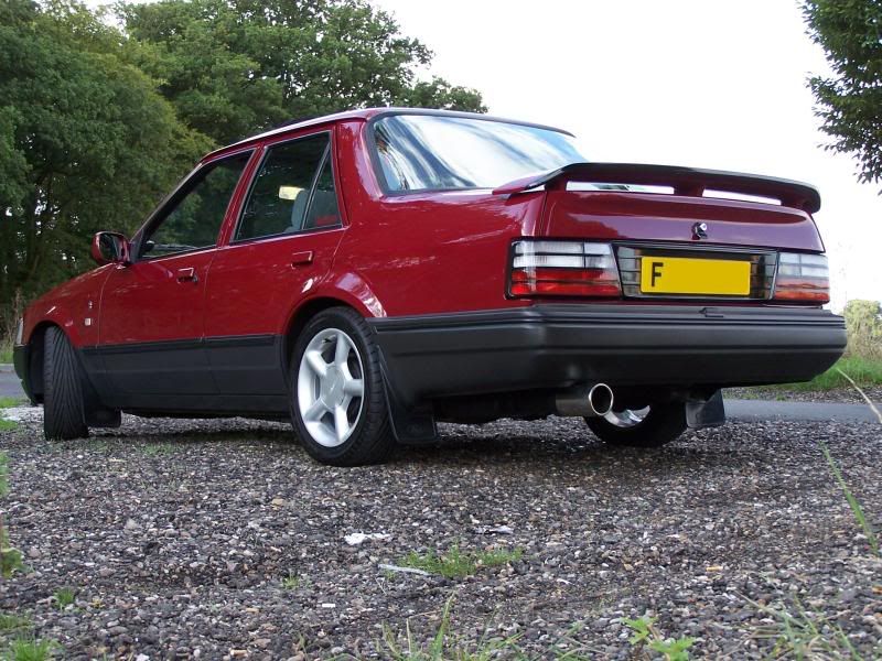

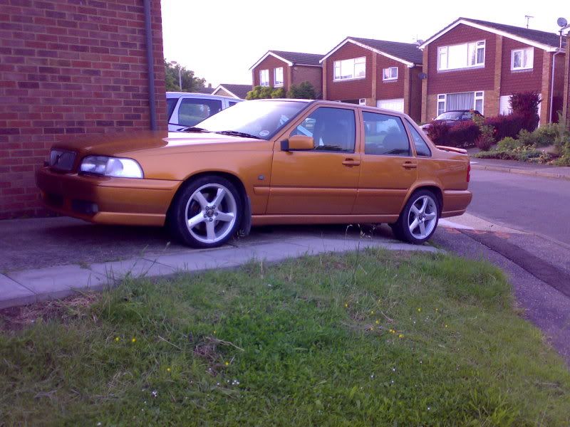

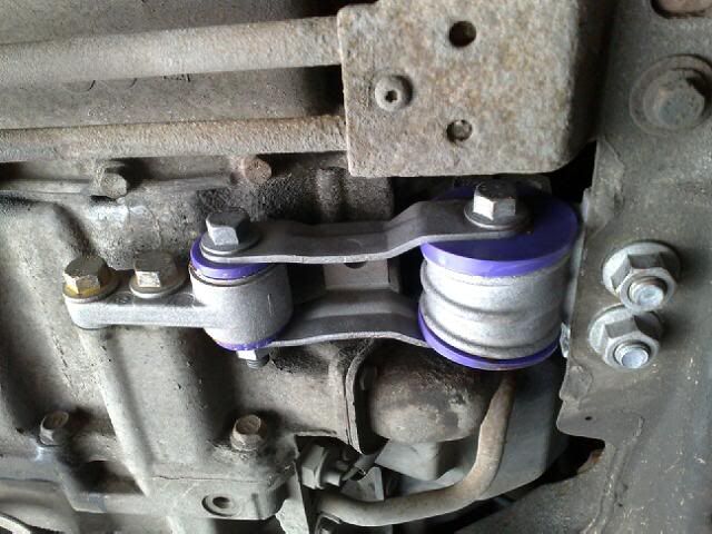

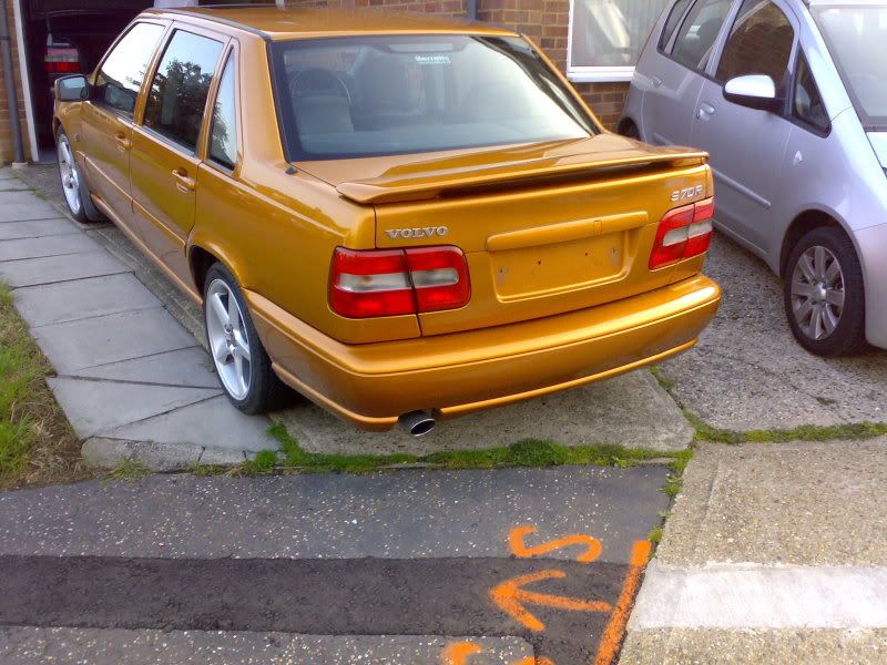

Hi i'm James and thought I would become a member to this forum. I have an S70R which i've had for 2 odd years now and i'm loving every second of it. I brought the car standard and after having a run in my brothers 854R which had been Rica'd I was shocked at what a difference it made so then came the bug to tinker.... My First car which I had for 7 years was a Ford Orion 1.6i Ghia again brought from standard and then couldn't leave it alone, Just a pic of the car before i sold it. Image Now back to the S70, afew pics from the weekend that I brought her, Image Image Image Then starts the mods, First off I got a new grille from My local Volvo dealer from a face lift C70 and also an "R" badge from an S60 R. Image Then a colour change for the wheels Image Then the engine mods, Rica ecu chip, Bsr air filter, samco blue hoses , Volvo front strut brace and a poly bush upper and lower engine mount. Image Image Thanks to Tomcat my next mod was ready to take place Image Image After being told by so many people how good they where I had to try them for myself, so along came the IPD roll bars and link rods. Also at the same time i had a set of goodridge brake lines fitted and a set of DS2500 brake pads fitted Image Image This is how the car looks so far Image Image Image That's pretty much if for now, more to come next year. Thanks for taking the time to look through my pics.

Very tidy looking S70R you have there. Not very often you see saffy S70's so nice to see one for a change. A good choice of sensible modifications too. I have the IPD anti-roll bars on mine they work a treat dont they! The DS2500 pads are worth their money too.... even though mine came on the car.

:welcome: IPD ARB drop links - not much good, I found. They are no more robust on longevity. Mine went in the bin after 18 months on the C70 - with the IPD strengthened ARBs. Can't fault the DS2500s. Been using them for years! Nice car btw ;)

very nice, did the Powerflex tie-bar bushes make much noise/vibration difference

Welcome aboard Jim. Nice car there - I really like my IPD f&R ARBs. Used standard VOlvo droplinks - but they are actually more expensive than IPD d/l. As Dave say, I have heard mediocre reports about IPD links - but not the hardest job in the world to change if they don't last. Rest of car looking great - really shiny: as it should be! Phil

[quote=p fandango;347076]very nice, did the Powerflex tie-bar bushes make much noise/vibration difference[/quote] The bushes make a big difference to the noise and yes you do get a fair bit of vibration through the dash when driving/ giving it some right foot ;) Thanks for the kind words, love what you have done with yours.

Thanks for the warm welcome guys and all the comments :) :) The IPD arbs i felt made a massive difference to the way the car drove even if they were alittle on the expensive side :( but hay nevermind. As for the link rods, well they where a good idea at the time lol.

Sorry I just re-read my post. I didn't bin the ARBs!! FCUK no - too expensive & I like them. No my comment was regarding the droplinks. They were a waste of money IMHO. Same as the QBE ones. Gonna stick to OEM from now on.

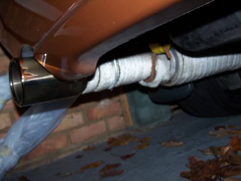

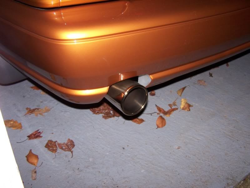

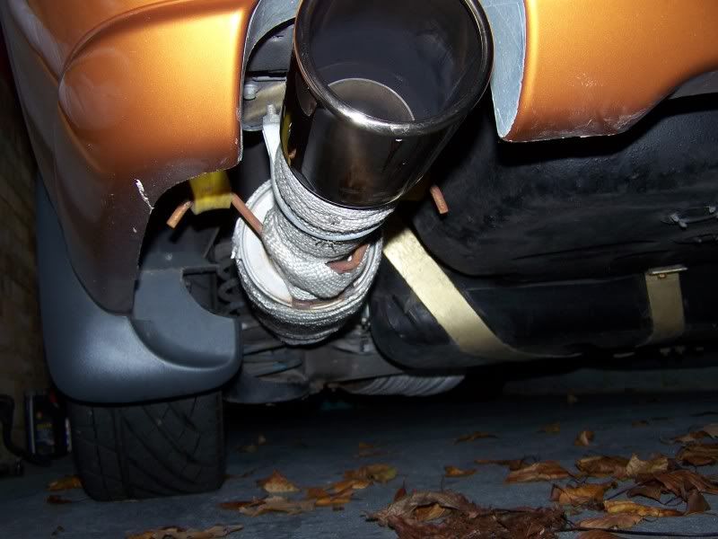

[quote=p fandango;347251]thanks, atleast my dash vibrating won't be a problem lol. You got any more plans lined up for the furutre?[/quote] The dash won't be rattling from inside the garage lol, it's funny you ask...... After my brother (Andysr) had his new JT 3" exhaust fitted I decided that it was time for me to change mine for something abit louder aswell ;) So I ordered a 3" exhaust and downpipe for JT tuning in Sweden. After a week of waiting the exhaust turned up :thumbs_up: Pics are not the best...... Image Image Image Checked the turbo while the exhaust was off Image The new exhaust with exhaust heat wrap Image Image Image Image After having the exhaust fitted Russ checked and adjusted the boost levels to make sure that they had not gone sky high with the new larger downpipe. It has made such a difference to the sound of the engine when driving, you can really hear the 5 pot growl :thumbs_up: Thanks again to Timo at JT for supplying the exhaust and a big thanks to all at RT's for fitting it. The car does drive alot different since having the new exhaust fitted, it seems to rev alot quicker through the gears and gives a nice pop and bang followed by a flame when slowing down ;) Something for 2011...... Image Image Ending up something like this Image That's pretty much me up to date with how the car is for now, I would like to say a big thanks to Russ and all at RT's for helping me get the car to how it is todate and not forgetting my brother aswell ;) Thanks for taking the time to read through my thread.

very nice, is that 3" to the cat then 2.5" back or a full 3". I notice Powerflex exhaust hangers as well, i remember your car from before because of the painted tank straps
Post 347263 by Jim S70R on 2010-11-26 07:41:57
[quote=p fandango;347257]very nice, is that 3" to the cat then 2.5" back or a full 3". I notice Powerflex exhaust hangers as well, i remember your car from before because of the painted tank straps[/quote] It's a full 3 inch from the turbo back with a 4 inch tailpipe trim, yeh that's me with the painted fuel tank straps lol

[quote=Jim S70R;347263]It's a full 3 inch from the turbo back with a 4 inch tailpipe trim, yeh that's me with the painted fuel tank straps lol[/quote] just noticed the heat wrap on the boost pipes as well, certainly being nice & detailed with everything. Nice one

[quote=p fandango;347309]just noticed the heat wrap on the boost pipes as well, certainly being nice & detailed with everything. Nice one[/quote] Thanks, I know it makes no difference but i just like the look of them wrapped :)

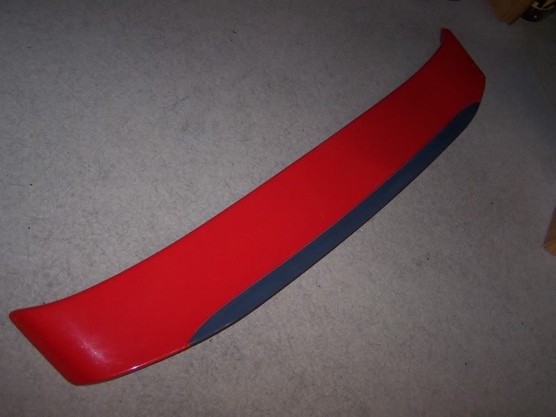

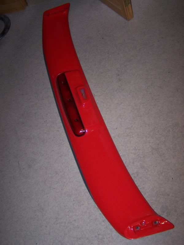

Let me know how you get on routing the wiring for the brake light on that spoiler, want to see how someone else does it..

[quote=Tomcat;348000]Let me know how you get on routing the wiring for the brake light on that spoiler, want to see how someone else does it..[/quote] Sorry Tomcat regarding the brake light I wont be using the lamp as I already have a high level light in the rear screen. I've already removed the guts/wiring to the lamp and will just leave it as a red lense :(
