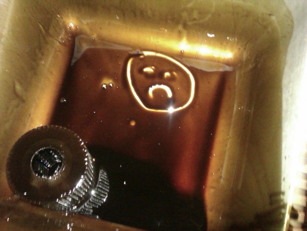

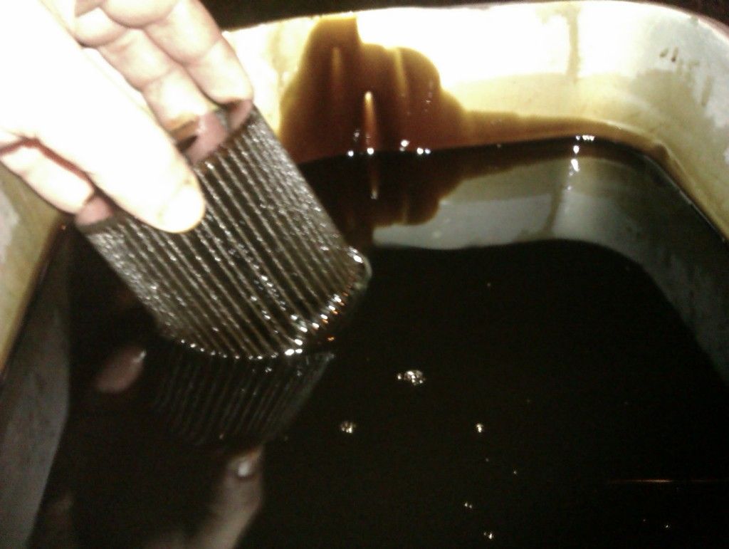

Post 415970 by M-R-P on 2011-10-11 22:01:17

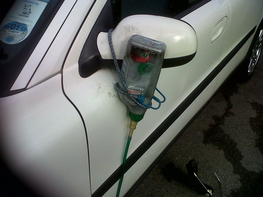

Just an update to my "rant" thread. I decided to flush the tranny on the Big Sweed today. Knowing how much of a pig it is to put oil into the gearbox, cos the fill plug is so far back in the wheel arch that a super soaker looks like the best option... I discovered Intravenous oil transfer... Image and into the stupid little hole... Image Image I made sure there was a hole in the bottom of the I/V bag(bottle) to allow the oil to flow. It wasn't exactly quick but it did allow me to have a poke about around the suspension. Here comes the annoying bit, I grabbed the driveshaft and gave it a wiggle and it had about half an inch of play - side to side. Bad news. So I began ringing round pricing up a new cv joint - 43 quid at best. So, me and the father in law started flicking through the haynes book of lies to see how many spanners the job was when I noticed that the picture of the hub in the book looked a little different from mine... theirs had a bolt holding the hub to the cv joint...! These bolts are far too long to just "fall out" so whoever changed the disk last (leicestershire plod) didn't put the hub bolt in! Couldn't get the bolt on it's own so I had to buy a cv boot kit for 15 quid, fitted and torqued the bolt and tadaa! no more wobbly driveshaft and no more dodgy knocking noise when changing gear!:) So new tranny oil, sorted cv and for an encore, I did a clutch fluid bleed (didn't do it when I did the brake fluid - D'oh If anybody want's a cv boot kid (minus the hub bolt) - £10 posted :)

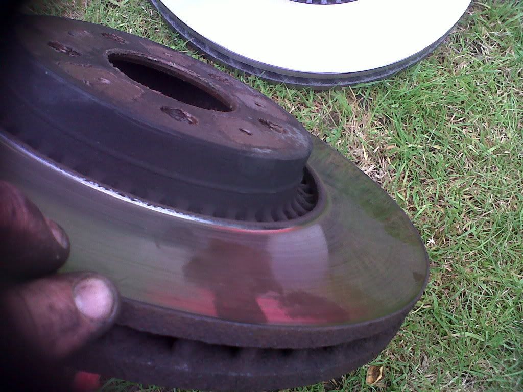

Ok, New 305mm Brembo disks today, £84 from GSF, not a great price but time was short. SO on they go... Image It's hard to see from the pic but the old disks were lipped to f**k and only had 22mm of meat left on them. Image Now, happy with my rather successful work, I thought I'd take the bro-in-law for a drive. No brakes, well, I had do put my foot through the floor to get anywhere near stopping. "Bugger" I deducted that the pads, which should have had loads of life left in them, were too mis-shapen from the knackered disk that bedding in was not an option. (I know, I know, you're supposed to change the pads when you do the disk) Having binned 84 quid on the disks, I was broke so the bro-in-law was kind enough to treat me to a set of oem pads (£37 from europarts) - GCheerz Roger! Happy days, new pads on - still no brakes! well slightly better than before but still not roadworthy and I deffo wasn't about to let my wife and son travel in it. So, back to the in-laws place (they got loads of tools and a driveway) Full brake system and clutch bleed, nothing. Had a wheel off trying to check the alignment of the carriers and piston etc. nothing. At this point I was about ready to call it and replace the master cylinder, then I saw something... At this point I would like to bring you back to this photo... Image Notice anything odd? Yes! I had that f**ckin spring thingy on wrong and it was buggering up the alignment of the pads. D'oh, facepalm, bang head with wheelbrace! So everybody, feel free to give me some serious stick over this... cos I did it on both effin wheels!!!!!!!!!!1 :( Hey-ho lives and learns!

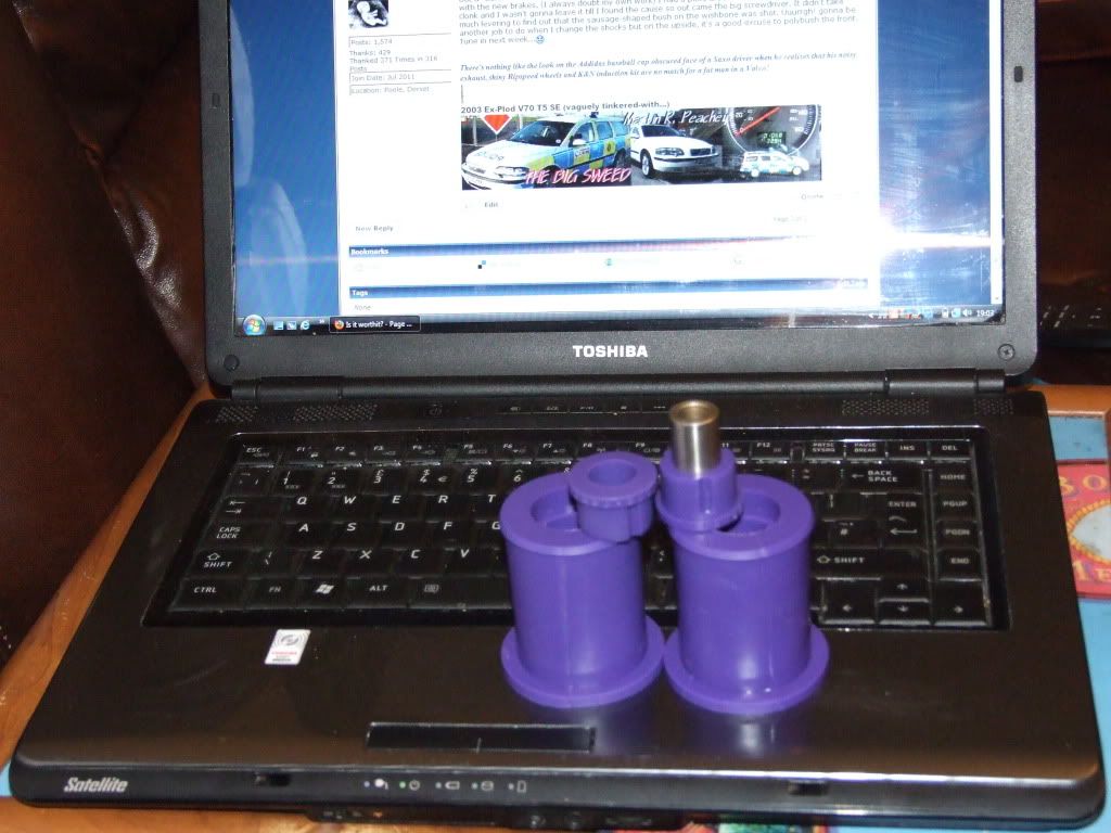

Post 421389 by M-R-P on 2011-11-03 17:19:14

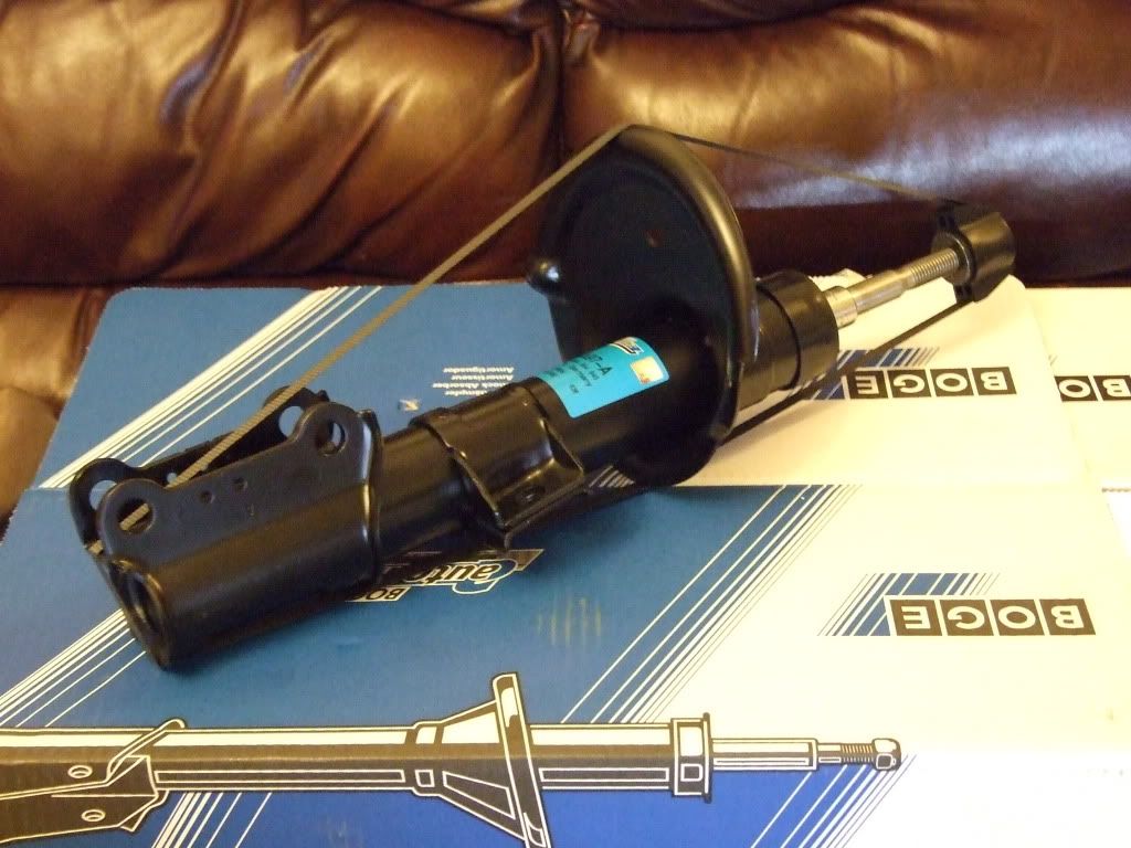

Ok, after pleading poverty to the guy at GSF, I got these for £190... Image A busy weekend methinks! After my roaring success (and subsequent smugness) with doing my PCV, who want's to bet weather or not I can get the polybushes in without completely removing the wishbones...?;)

Ok, tomorrow I tackle the shocks and bushes. Any suggestions, advice or quick fixes I should know about? I'm pretty good at this sort of thing but I've never done this before. For an extra challenge, I'm gonna try to do the polybushes without removing the wishbones (don't try to talk me out of it ;) if it goes badly, the wishbones come off, if it goes well, I'll post a how to:)) but the shocks... Simple? anything to look out for? I'm thinking of partly compressing the spring before I take the shock off, supporting the wishbone hub assembly, with the hub bolt out and the driveshaft pushed back into the tranny. Then removing the strut and undoing the front of the wishbone, wedging it forward then doing the polybush while the father in law is putting the spring on the new shock. Sound like a plan? As always, you're skills and knowledge are gratefully received and all input is welcome. Martin.

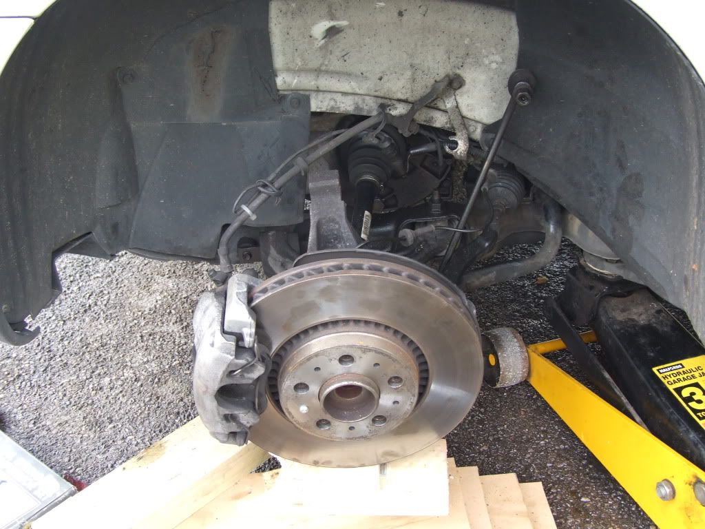

Kick-off! after a ribbing for reversing into a pickup, from the in-laws! n/s wheel coming off...
Post 421825 by p fandango on 2011-11-05 12:56:25
you not done it yet? i'm waiting to see your guide so i can see how i've got to do mine lol

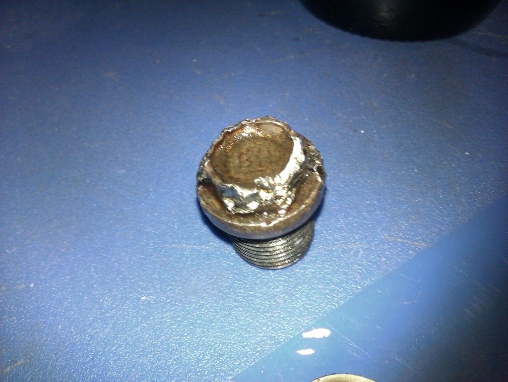

Post 421830 by M-R-P on 2011-11-05 13:24:38
Bent one of the big bolts holding the hub carrier... sending the missus out for 4 new ones :( I used some blocks and some wire to keep the hub carrier steady after taking the shock out and undoing the wishbone bush. \remember - remove the hub bolt and push the driveshaft back into the tranny. Image Checked the droplink - luurrrvely!:)

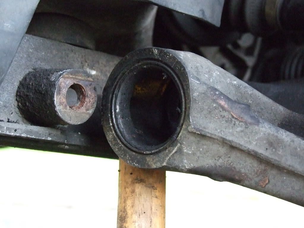

Post 421833 by M-R-P on 2011-11-05 14:18:50

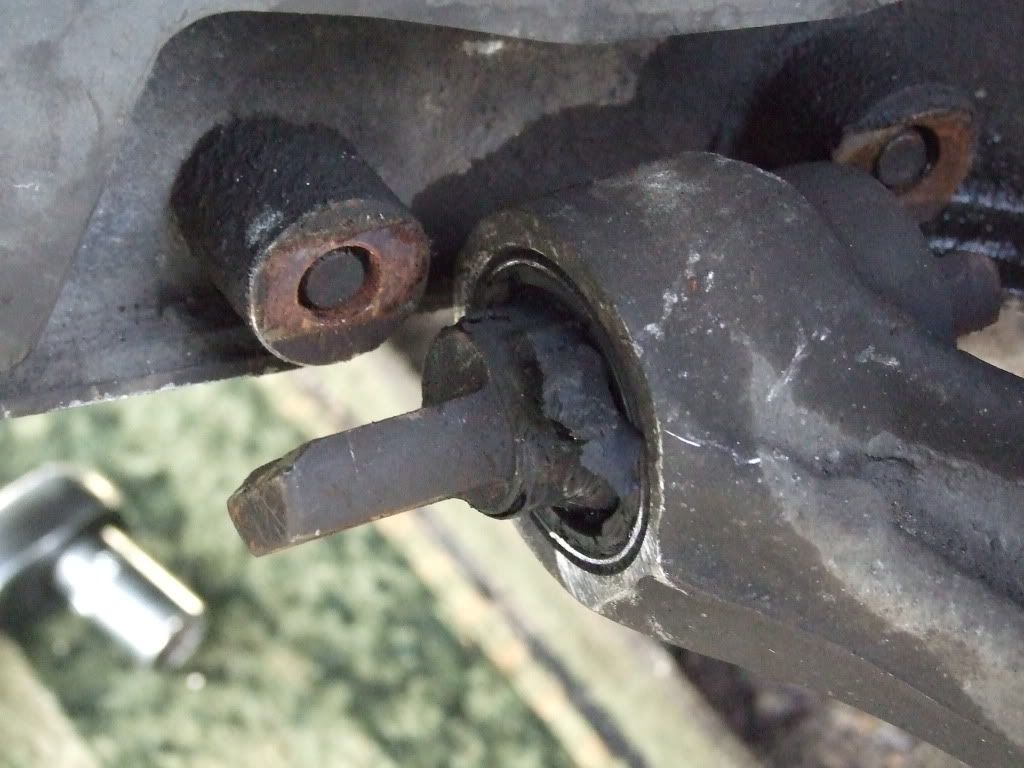

old wishbone bush out... pig of a thing that was...note... pic was taken BEFORE I realised that the outer metal casing of the bush needed cutting and removing. Image I found that, rather than pressing it out, I drilled through the rubber a few times and with a couple of spanners, turned and turned (strong wrists required) until "crunch" out it popped... Image

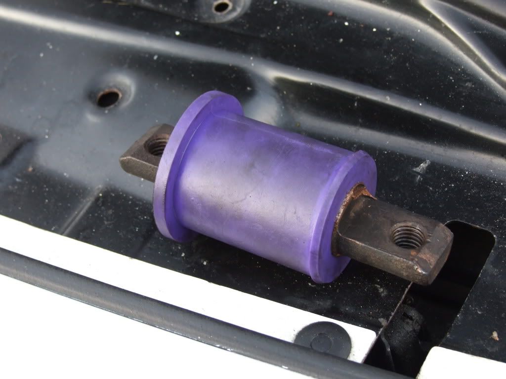

Post 421860 by M-R-P on 2011-11-05 16:54:17
New bush in... Image I tried using a jubilee clip to get the bush into the wishbone but that annoyed me so much, it wasn't worth it. In the end, I used a G-clamp and wedged one side of the bush in the wishbone then prise the rest in with a screwdriver to get the lip in. Then it was a matter of winding it in with the clamp. I'll get more pics of this procedure when I do the other side, tomorrow.
Post 421914 by M-R-P on 2011-11-05 19:00:43
Just had some dinner... 6 hours to do one side. I put the knackered bolt back in for now (it was just a little bent) till I can get a new set on monday. Admittedly, most of the time was wasted on wtf moments, like not realizing that I had to cut out the metal outer bit of the old bush before the new one would fit in. It was all pretty simples when I worked out what I was doing. I'll post some pics later, when I get home. Gonna get back on it first thing tomorrow and update as I go.

Ok, shocks and wishbone bushes done. http://www.vpcuk.org/forums/showthread.php?t=38699 Today it's inner and outer track rods, new lower shock/hub assembly bolts and front shock top mounts;) Anybody remember the film "the money pit"? I'll keep yall posted on the progress...

Ok, on a mission today... Got the inner and outer track rods and top mount rubber spring retainer thingys from GSF (£75) and replacement hub carrier bolts from local stealer (£10.80 - not bad at all) Raining all day so wanted to get stuck in. Did myself proud, within 15 minutes I had the N/S strut out, spring compressed and the top mount replaced. Put it back in with the new bolts - lurrvely! Pig of a job getting the N/S outer track rod off but managed it relatively quickly. I should now explain that this was 13:30 and I had planned to get the car to ProTyre to get the tracking done. So... I grab the new track rod and go to screw it on - bloody thing was about 40mm too short! :( So, back to GSF, bloke behind the counter tried to stall until he realised that he picked the wrong part and promptly handed the correct one to me with a mouth full of humble pie. N/S all back together. As before, flew through the O/S shock top mount. Wrestled the old inner O/S track rod off, put it next to the new one... 60mm too bloody long. By now I had suffered a total sense of humor failure and was ready to pick the little pipsqueak up by his ears if he tried to wiggle out of a second f**k up. Long story short, got some discounted bits n bobs as a sorry. Finally got the car back together at 17:30, had to pick the little Volvo nut up from nursery and collect Mrs MRP from work all before 18:00. Needless to say, I didn't get the tracking done but to get it close, I used a stringline and a bungee. The steering wheel is just off center and it wanders, slightly to the left but it's still better than when we first got the car. Oh, the camber is a little off too - she now rubs on full right lock. Tracking tomorrow:) Rant over, thanks for reading!

Well, she's all sorted, mechanically at least. A few bits and bobs left to do but nothing that can't wait till the bank account has recovered. To celebrate, last night I had a couple of beers while doing a bit of tinter-webbing on my lappy. I went outside for a fag, took the lappy with me so I didn't miss anything. When I went back in, I don't know if it was the beer or just bad luck but I slipped on the step and dropped the lappy. It bounced down three steps and came to rest by the door. Anybody know where I can get a screen for a toshiba satellite for... (jingles change in pocket) 85p? It never bloody ends:(

Post 435076 by M-R-P on 2011-12-10 23:06:29
Well.. Coolant flush today. I wouldn't have bothered but one of the hoses that connects to the bulkhead for the heater matrix has a leaky connection and I wanted to investigate. Couldn't find the drain tap for the block so ended up having to use the one the rad and dilute - several times :( Moan over!

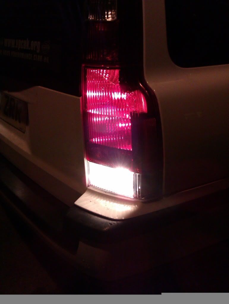

Dipped beam bulb blew today so it was a good excuse for me to look for an upgrade. Found Ring XenonMax, on offer in my local Motabitz at £16.99 the pair. Very nice, bright, white light. Only a quid more than online price too :) So, just went on fleabay and got these... http://cgi.ebay.co.uk/ws/eBayISAPI.dll?ViewItem&item=270490315777 (I know they're not road legal, but whose gonna see 'em? lol) and yes, they'll probably blow the first time I flash somebody through, but, for the money, who cares? lol
Post 441907 by M-R-P on 2011-12-31 01:33:48
Got the new main beam hb3 bulbs yesterday. If you check the link above, they are advertised as "power white" and the pic shows a silver coating on the glass. They're not. They are the finest shade of chav blue. I'm not happy about this but they're fookin bright, really fookin bright and the return postage will be almost as much as the price of the buggers, so they stay until the mot.

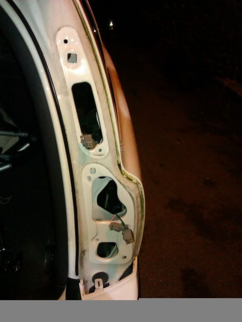

Post 455125 by M-R-P on 2012-01-27 11:55:23

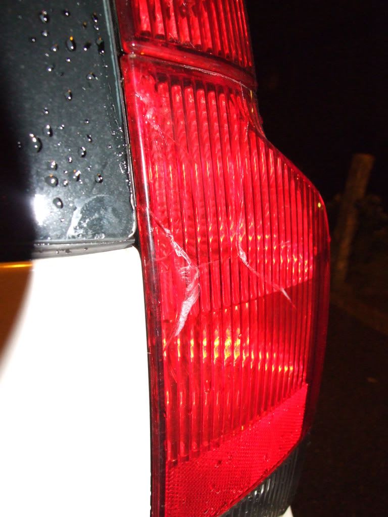

Somebody reversed into the front of the Sweed last week. They dragged the rear wing/bumper of their 59 plate Mazda 6 (shiny white) down the side of my front bumper and arch. They did it while I was stood in front of them, watching. After I shouted and waved my arms at him, he pulled forward, got out and said "did I hit it?" Berk. After I gave him some concise tuition on how to use mirrors, I went over and inspected the damage to the T5... Image He followed behind me, mumbling something about exchanging details and looking rather scared (he was half my size and I'd gone very quiet) The damage to the Volvo was nothing I couldn't sort out in a few hours so before he's finished asking me, for the third time, weather I wanted to exchange details, I walked round him, still silent, and looked at the damage to his car. He scuttled along, a fair distance behind me. When I saw his car, I laughed and said "Naaah, you're alright mate" The Big Sweed had left an 18" crease along his rear arch and cracked the bumper lol. Moral of the story? Don't pick a fight with a Volvo! :) As I pulled out of the car park, he was on his phone and I heard "Yes, I know, I know, but, but..." I haven't seen the Mazda since (it was a nursery car park and it's usually there every day)

Post 456738 by p fandango on 2012-01-30 14:27:45
[quote=martinrpeachey;456715]Biggest concern at the moment is getting the locking bolts out - key is now totally mangled and, as I found out recently, drilling is not an option :(.[/quote] i'll get it off for ya lol Image
Post 456766 by T5frankie on 2012-01-30 16:28:05
[quote=martinrpeachey;456723]Yep, that's plan B mate, I just gotta find 4 sockets to ruin! Ever seen me swing a hammer? I used to make bespoke, oak framed buildings as well as doing a lot of axe-work when the workshops were quiet... Image ;)[/quote] you usually can get them back off again undo them but not right off and whack them from side to side with a hammer, use an impact socket if you have one
Post 456769 by M-R-P on 2012-01-30 16:33:33
[quote=p fandango;456738]i'll get it off for ya lol Image[/quote] My mate has 3 18" TSW Venoms in his shed. the fourth is there but is missing the middle bit ;) [quote=t5frankie;456766]you usually can get them back off again undo them but not right off and whack them from side to side with a hammer, use an impact socket if you have one[/quote] Nice one Frankie :)
Post 456770 by daza-b on 2012-01-30 16:34:32
[quote=p fandango;456738]i'll get it off for ya lol Image[/quote] looks like a locking nut was in the middle there at one point hahaha
Post 456773 by p fandango on 2012-01-30 16:41:11
[quote=martinrpeachey;456769]My mate has 3 18" TSW Venoms in his shed. the fourth is there but is missing the middle bit ;)[/quote] Vemons, i'd sell the remaining 3 to the Antiques road show lol
