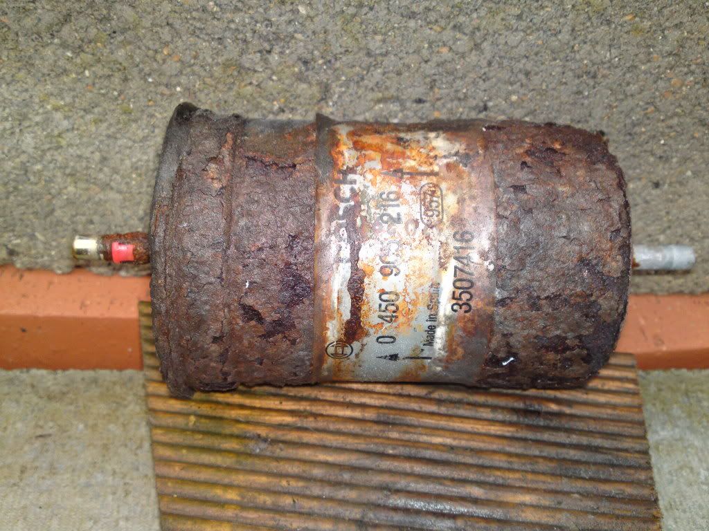

Post 425785 by endo-t5 on 2011-11-14 17:32:37
I'm amazed that my t5 went at all with this on it, I can't believe how bad it was and should of known that last owner wouldn't have done it as he said he had done other things that he hadn't and should of done it earlier but since doing a disc in my back last year takes me ages to get under a car and do stuff. Image

Post 425792 by endo-t5 on 2011-11-14 17:43:56
yes the coupling's can be a real pain took me 3 hours to do the filter change and had to put new nut on the bracket as bolt snapped and next time I do it think I will order some disconect tools as using spanners worked but would of been easier if I had the right tool, saying that think it's been on there for a long time.

Post 425867 by M-R-P on 2011-11-14 20:04:55
Tip for removing the connectors - plier-type wire strippers, good for squeezing the tabs on the side. Old bill wrap them up in tape so they don't corrode.
Post 425868 by endo-t5 on 2011-11-14 20:05:06
Just been out to see my baby granddaughter and car is like a new car felt like it was pulling better low down and when on boost oh I'm happy now why didn't I do it ages ago.

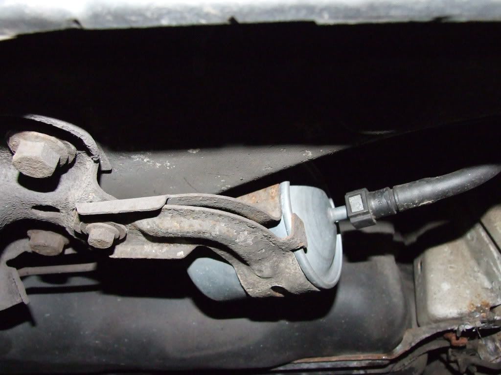

anyone have a photo showing where the filter is located?

Post 426007 by M-R-P on 2011-11-14 23:18:51
Just in front of the O/S rear wheel... Image Not bad considering I just pointed the camera under the car and fired! Hmm, looks like the fuel tank bracket needs some work...

Post 426031 by ncarnall on 2011-11-15 00:15:07
cheers mate, will look at mine in the morning. what special tools are needed to open those connectors safely without breaking them?
Post 426033 by M-R-P on 2011-11-15 00:17:19
[quote=ncarnall;426031]cheers mate, will look at mine in the morning. what special tools are needed to open those connectors safely without breaking them?[/quote] Squeeze the grey bits together and pull (sometimes puts up a fight). Took me 5 mins. Wrap the conns with tape when you reconnect to prevent agro when replacing the filter next time.

Post 426067 by endo-t5 on 2011-11-15 10:47:25
The p1 cars have different connectors and they slide and I used a 17mm spanner and had to get another spanner in behind to force it of so be warned can be a nightmare on early cars.

Post 659957 by Harvey on 2013-11-12 15:02:29
[QUOTE=endo-t5;425785]I'm amazed that my t5 went at all with this on it, I can't believe how bad it was and should of known that last owner wouldn't have done it as he said he had done other things that he hadn't and should of done it earlier but since doing a disc in my back last year takes me ages to get under a car and do stuff. Image[/QUOTE] No this is. Ok this is a old thread. Image

Post 659985 by Harvey on 2013-11-12 16:30:30
[QUOTE=M-R-P;659962]Nevermind the thread resurrection, I can't believe you bothered to put the protective caps on it lol.[/QUOTE] Though It might help keep the petrol in,it didn't .

Post 660264 by Harvey on 2013-11-13 08:35:28
[QUOTE=jdavis;660243]That's shocking was that on the r?[/QUOTE] Err yes the S60R volvo say it needs changed at 96k miles & it was done eary
