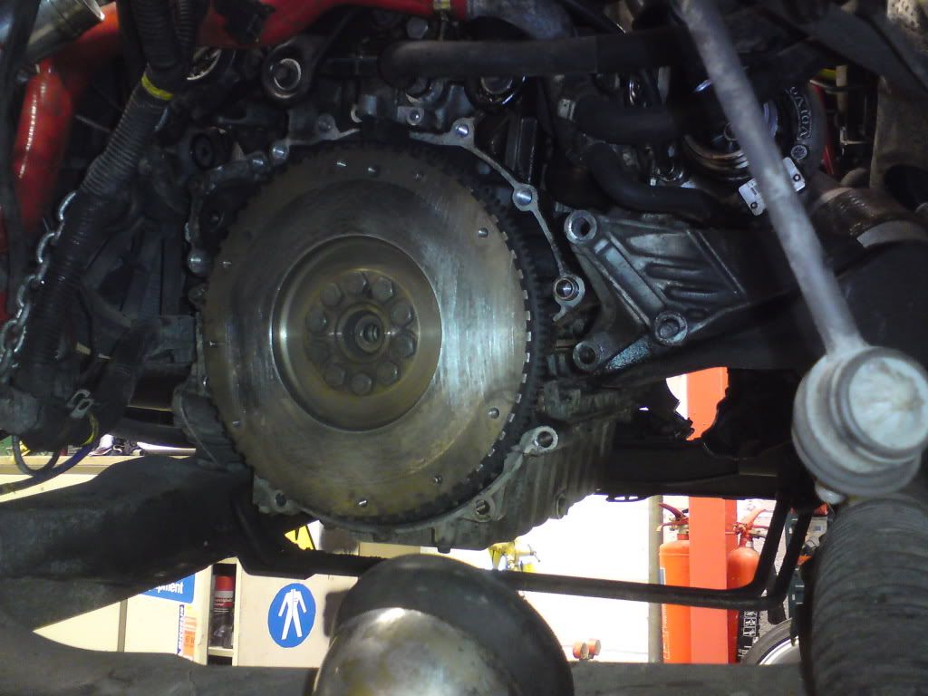

Post 497654 by t5 pete on 2012-05-12 19:12:55
Does it look like this Image

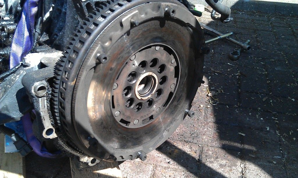

Post 497674 by oblark on 2012-05-12 19:28:18
[quote=t5 pete;497654]Does it look like this Image[/quote] Mine looks like this Image The friction plate has no springs in it. Over the last week after my cambelt jumped I discovered that someone in the past has replaced the orginal engine/box for a early V70 engine/box.
Post 497683 by t5 pete on 2012-05-12 19:33:41
Certainly not like the single one in myne then lol
Post 497690 by Dangerous Dave on 2012-05-12 19:38:29
My dual mass is different, but I suppose its an earlier (crappier) design.
