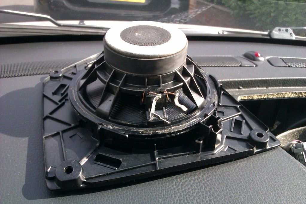

Post 535702 by M-R-P on 2012-09-08 19:59:30

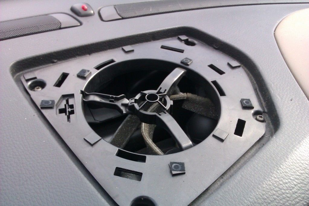

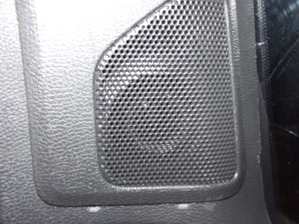

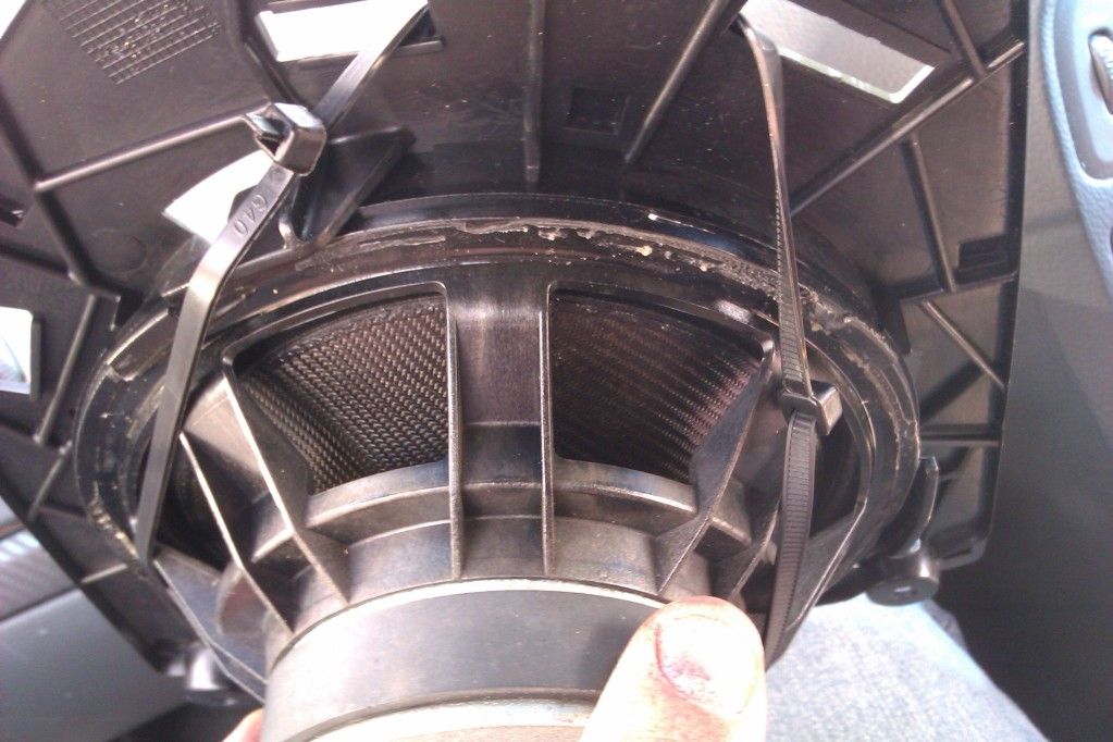

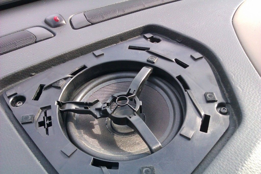

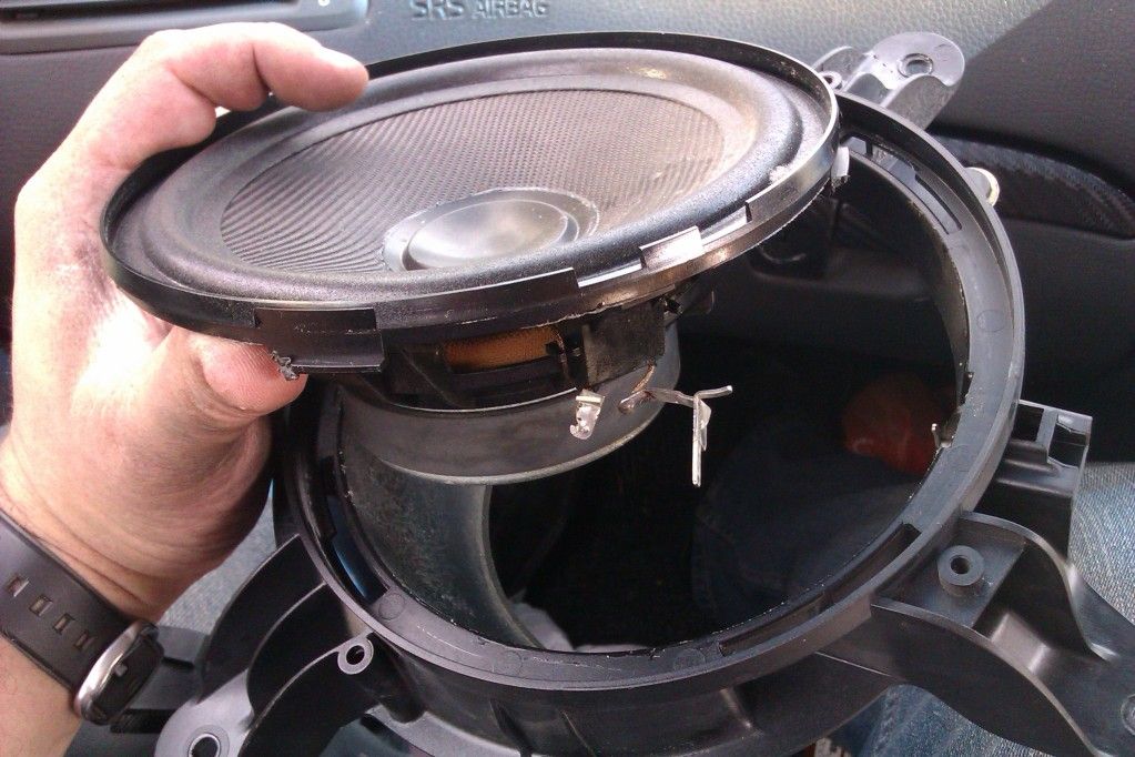

Ok... Update... Got the speakers hooked up, and 6 channels of cables implanted down the length of the car, hidden away. fired it all up and as I predicted, not fantastically loud but sounded nice. I faffed about for a bit, setting the rear speakers and sub up. Then I turned my attention to the dash centre speaker. was there a speaker in there? Could I wire it up..? Image Nuts! Hang-on... I had a spare Dynaudio door speaker left over from a door swap... Prise it from it's cage... Image Make it fit... Image "Secured" with cable ties... Image Mounted! and by a stroke of luck, it had a connection in the dash which worked :D Image Now that was all well and good but when I started setting the attenuations, I could hear a whistling noise coming from the back... My worst fear, the Creative amp was just not designed to work in a car lol. I could remove the negative from the power supply and it still ran! It was grounding through the head unit which doesn't matter in home audio but in a car - not good. :( So I ripped everything out and fitted a pair of Subwoofer cables that ran through the car to the boot. While deciding what to do about the sound in the D-pillars I pondered weather or not there would be connections hidden away as there were for the centre dash speaker - after some rummaging about in the depths of the rear lower looms Ta-Daa! working D-pillar speakers :D It then became apparant that I didn't have a sub... Oh wait... I've had this at the bottom of the stairs for ages, it's owner gave me the OK to try it out so... 2 x Diamond Audio 12" subs with a 2 channel Kenwood amp @1000W... Boom! Image I'll be sad to see 'em go now lol. The wife's not pleased - lost a third of the boot lol.

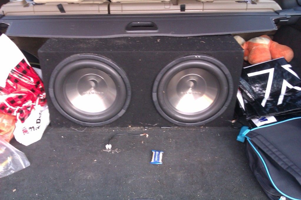

Post 535725 by d2k on 2012-09-08 20:48:57

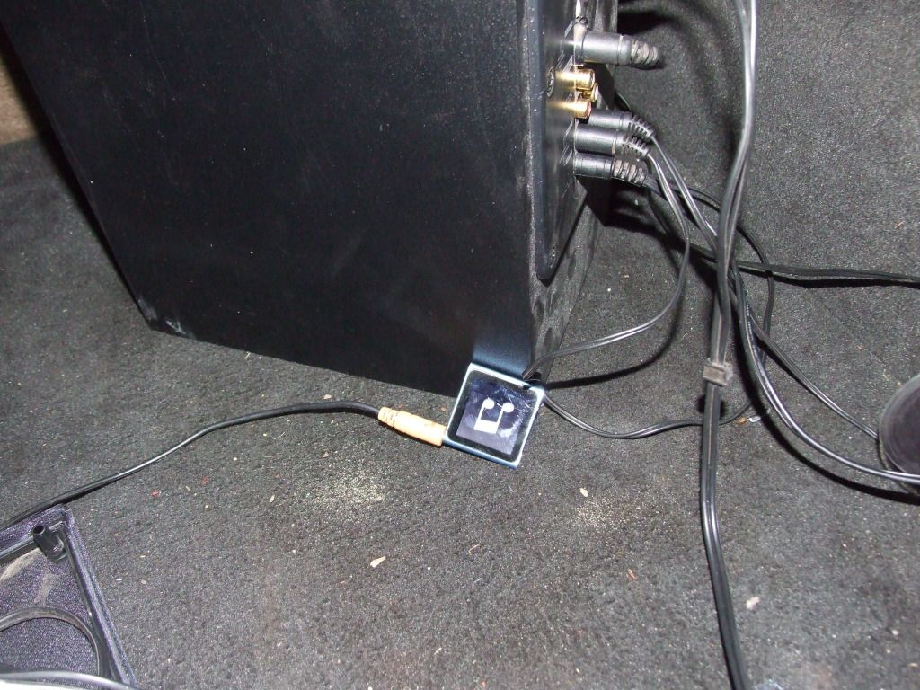

ok so here's the replacemets for that huge thing taking up your boot... Image so weve got a 10'' Lanzar MAX, cracking litte sub 400wrms capable, in a 0.9cuft ported box i had made for the specs of the sub. Ripspeed R2100 200wrms x2 300wrms bridged... great amp.. the missus wont even notice this in the boot....lol
