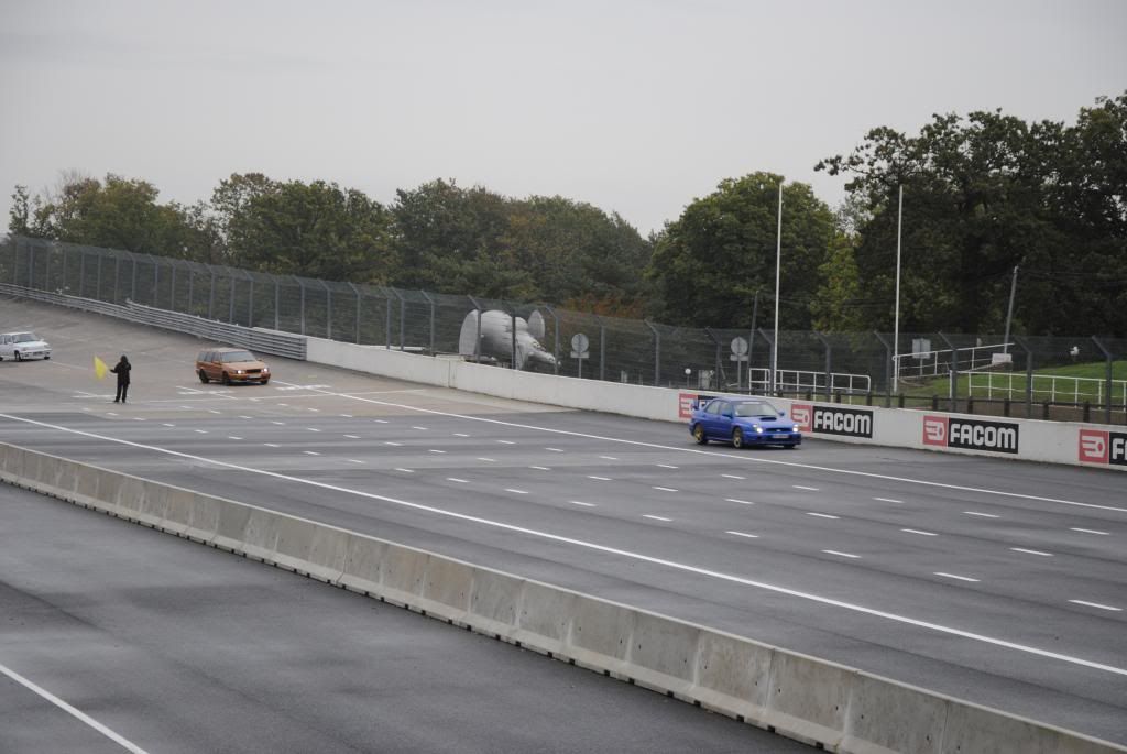

Hello Vikings!!! Some news of my Volvo. The last week I made an exit on the Montlhery circuit in France. It rained all day and it allowed me to test the AWD system, my tires Continental sport contact 5 and my Wilwood brake kit front 330mm. The tires are great in the rain, the AWD system is also effective and I have virtual limits of my model for my Volvo weighs 1652kg and it is heavy! So today I can say that the limits of my braking system in rain and my current setup is launched at a speed of 125m of 140/150km/h. I can stop at 100m but I can not turn out well, but it goes still Some pics: Image Image Some vidéos [video=youtube_share;srse0Tkm6LM]http://youtu.be/srse0Tkm6LM[/video]
Post 544877 by rise94 on 2012-11-02 19:47:56
[video=youtube_share;_OvvRRo6p_Y]http://youtu.be/_OvvRRo6p_Y[/video]
Post 544878 by rise94 on 2012-11-02 19:48:29
Time 20 min 10 , I brake at 100m!...And it's short.... [video=youtube_share;MJPB2xpBzeg]http://youtu.be/MJPB2xpBzeg[/video]
Post 544886 by T5frankie on 2012-11-02 20:15:05
good videos mate
