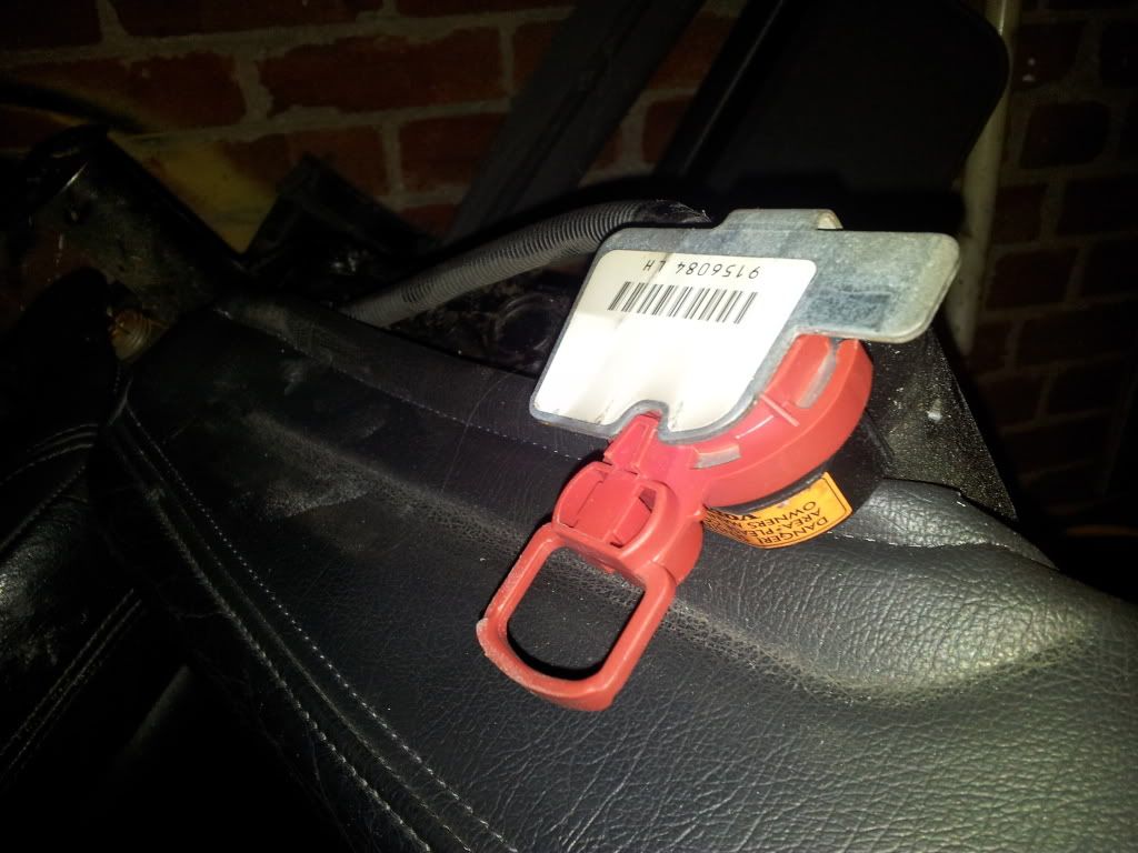

I need to change the drivers seat (manual) on my 2002 C70 2.0 GT. Using the Haynes manual as a guide I've taken the side plastic cover off where the seat adjusters are but found no sips key in the holder nor anywhere for the key, if it were there, to plug in to stop the seat airbag going off if I start removing the seat. The cover has sips written on it and there is a sticker on the door pillar advising of its presence. Am I not looking in the right place?
Post 612975 by claymore on 2013-06-02 19:00:30
This is what an 850 one looks like if it helps. Image
