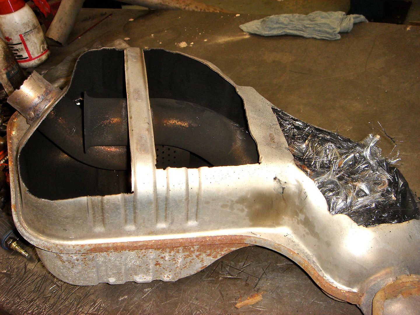

Stephenevans dissected his backbox and it was rammed solid with packing fiber. Hugely restrictive.

[QUOTE=M-R-P;614111]Stephenevans dissected his backbox and it was rammed solid with packing fiber. Hugely restrictive.[/QUOTE] I remember that. There are some pics of it on here somewhere i think. Might look in to that option

Post 614325 by stephenevans99 on 2013-06-07 06:58:11
Here's a few pics of my back box cut open showing the restriction: Image Image
Post 614335 by silverhorse on 2013-06-07 08:59:12
[QUOTE=stephenevans99;614325]Here's a few pics of my back box cut open showing the restriction: Image Image[/QUOTE] Cheers for those Steve. Did you take the box apart just cos you were bored and wanted to destroy something!!?? or did you patch it up again once emptied and put it on the car? If you put it on again, what did it sound like?

Post 614344 by stephenevans99 on 2013-06-07 09:30:25
I had the back box cut open after I had my s/steel system put on. I think the restriction is the fact that the gases enter into the centre section first then travel through the baffle into the front section and then through the pipe to the rear & through the nylon packing. Image
