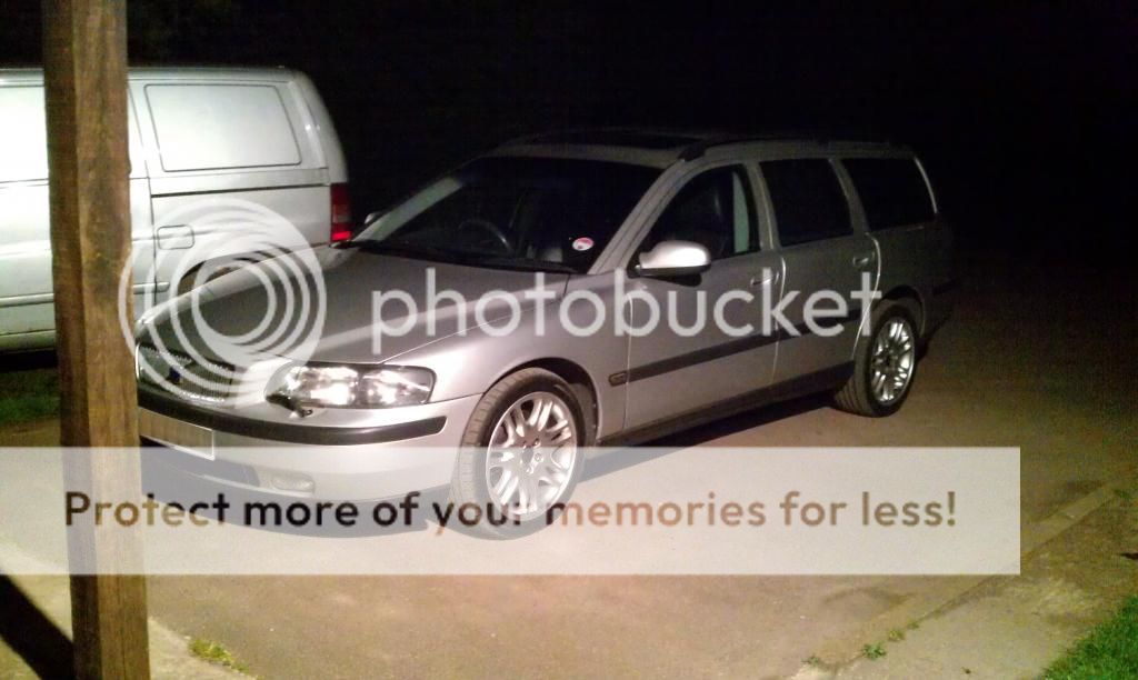

After owning a couple of 855 T5's, a C70 T5 and a p1 V70 tdi I've eventually bought a p2 V70 T5 :) Image A terrible picture but she's a bog standard car with plenty of miles, some history and a nice old thing. A few foibles........lumpy cold start has given way to lumpier cold start and non-existent idle when warm/hot. I unplugged the MAF and it ran fine so I'm hoping £145 of Bosch will sort that out (No codes on the dash yet). I drove it 20 odd miles home (no boost or real throttle inputs) and it was smooth and refined. Also, the brake pedal is making a weird kind of hissing noise when there is no pressure on it. It becomes silent when you touch the brake, and the brake force itself is fine. Any ideas???? Last weird oddity is a water slushing noise when turning left or right at slow speed that seems to be coming from the engine bulkhead. There doesn't seem to be any obvious damp in the car such as water ingress but I haven't had the parpets up yet. The interior is mint, the exterior is very good apart from lacquer peel along the leading edge of the OSR door and a couple of small scuffs towards the back. It really is a lovely place to be, but then you guys know all about that! Plans are simply to give it a good service, replace the MAF asap and then just upgrade and improve bits as and when they fall off or fail. Any ideas about the above would be useful as the knowledge with garages seems to be very varied and I'm keen to avoid big bills with this one if I can :D Cheers
