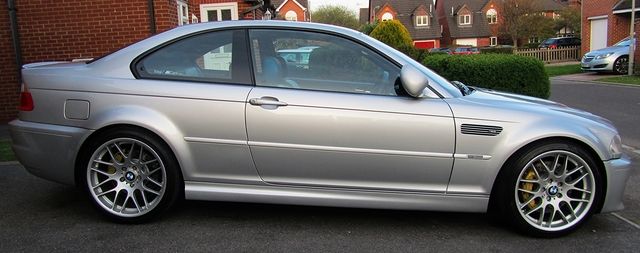

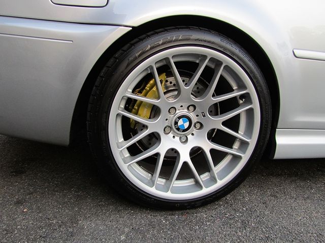

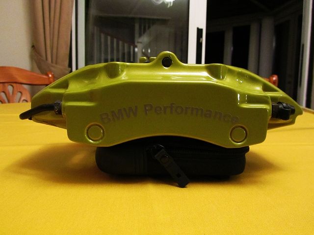

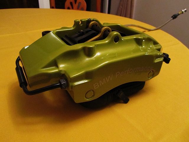

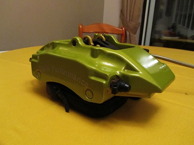

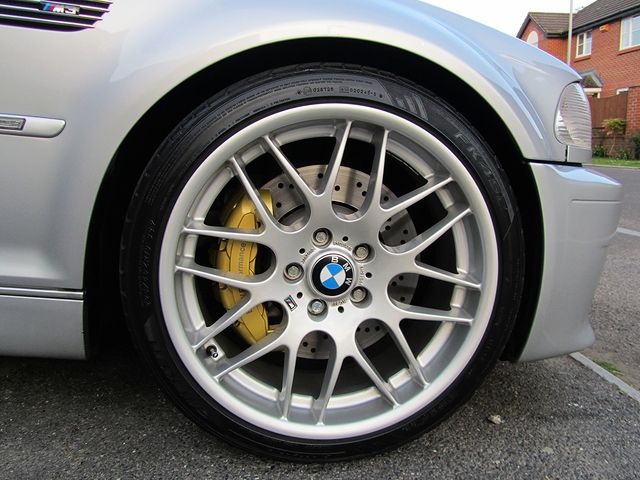

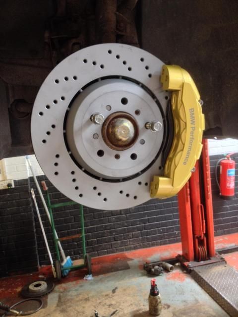

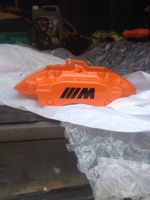

My rear big brake kit arrived yesterday and the previous owner had them painted Porsche GT3 orange. As my front b.b.k set up comes from the factory painted BMW Phoenix Gold, I wanted the rears to match. My front setup are these. Image My rear setup arrived like this. Image On the previous owners car. Image They look like this now after me painting them, adding performance stickers, then lacquering and then fitting all the link pipes and nipples etc back on. Image Image Image I'm really happy with how they turned out. Roll on Thursday when they get fitted to my car :B_steerin
Post 769081 by volvokid on 2015-04-19 01:14:34
Was it easy to do this mike?
Post 769082 by MIKESC70T5 on 2015-04-19 01:48:24
Yes mate, I took everything off so I was just left with the caliper housing. 180 grit wet/dry rubbed down. Masked off the Pistons. Tak rag, wiped over the caliper. Sprayed the paint on, 5 coats in total. Let dry overnight and then attached stickers and then a few coats of lacquer applied. Refitted all the bits.

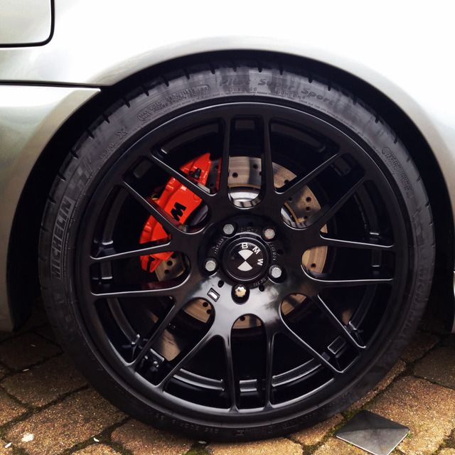

Post 769789 by MIKESC70T5 on 2015-04-23 23:10:24

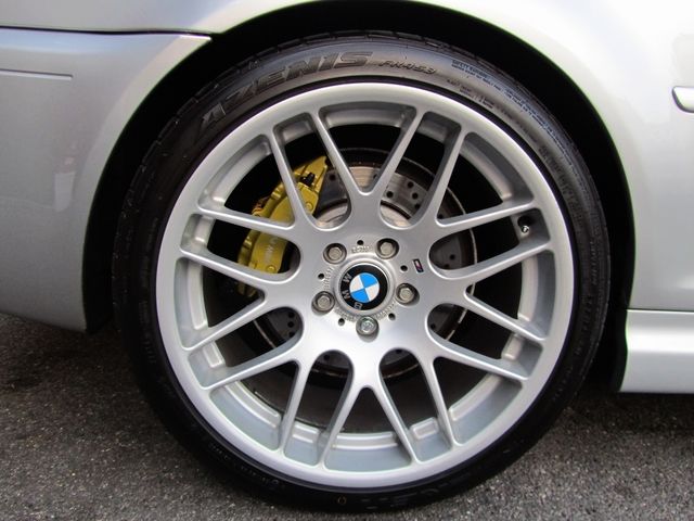

Rear calipers fitted today :) Image Image Fronts Image Image
