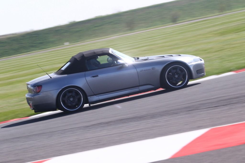

Post 811503 by KEITHS on 2017-05-02 17:55:33
Image Had its first track day at Bedford last month It performed very well with no issues My son enjoyed his 1st track day in it and is annoyingly a good little driver with a good feel for the car and what is happening
